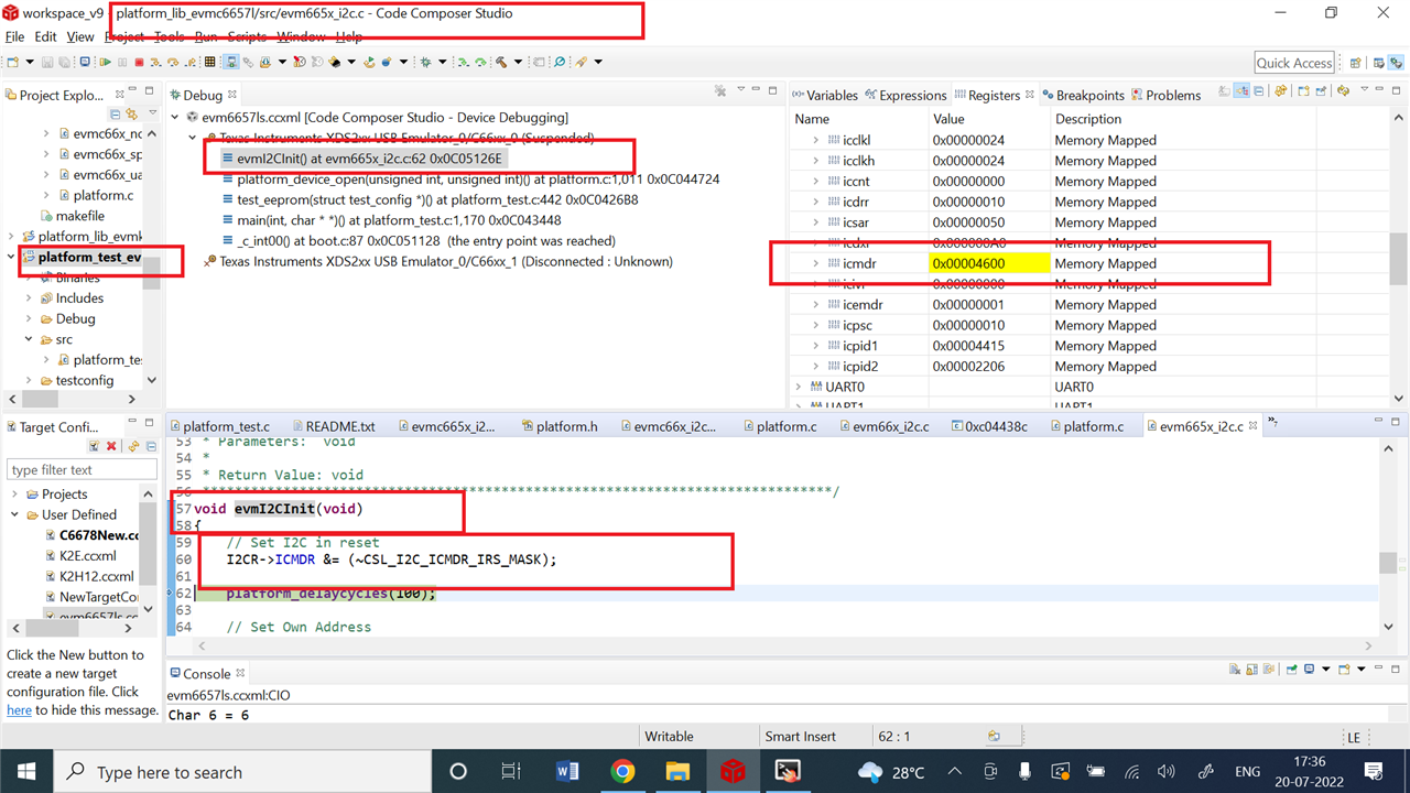

I'm trying to create an I2C driver and I am trying to test it through the digital loopback. I am using the platform_lib_evmc6657l I2C and I2C_eeprom as an example and set the digital loopback (DLB in ICMDR) so I can view the ICDRR to verify if the value was written to correctly.
I'm having trouble with the write function as I am expecting the value to be in ICDRR, but when I step through it, nothing is being written to that register.
I first start by initializing the I2C by calling evmI2CInit() in evm665x_i2c.c. Then inside evmc665x_i2c_eeprom.c, I change the function i2cEepromWriteBlock() so that it sets the DLB when it also sets the start bit. From there, I keep everything else the same.
Is there something that I am missing for the digital loopback?

  • Cynthia,
    I do not see any issues, in the I2C register values...when I run the Platform test....
    Are you able to run the Platform test code successfully on the C6657 EVM?.
    Because, the Platform test includes the test routine for the I2C-EEprom using the "test_eeprom".
    I am able to access the I2C registers and visualize the values of them.
    During EEPROM read and write, able to see the appropriate values on the ICDRR, IMDXR registers too......
