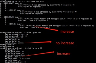

1. We tested the IET functionality on the TDA4 board, and the configuration is as follows:
And we send data through iperf, and at the same time we send data through sockets in user space, Iperf commands are as follows
iperf3 -c 192.168.100.20 -u -b500M -l1472 -t300
iperf3 -s
2.测试结果如下:
  1): We sent data from user space via socket(priority 3), then through "ethtool -s eth0 | grep iet" command found that "iet_tx_frag" counter  is not incremented
  2)We sent data from user space via socket(priority 3) and find that "tx_pri3" counter increases as well

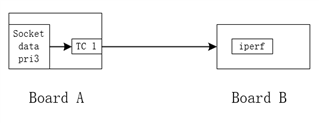

  • hi:
        The change you provided is not the result I expected, I expect the following results:
            1:pri3 map to tc 1  and  map Tx queue 1
            2:   pri0-2 and pri4-7 map to tc 0, and map Tx queue 0
          I may have been a little unclear, but let me describe my test in more detail:

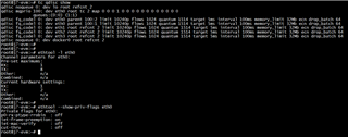

            config:
                 board A:
                      ifconfig eth0 down
                      ethtool -L eth0 tx 2
                      ethtool --set-priv-flags eth0 iet-frame-preemption on
                      ifconfig eth0 up
                      ifconfig eth0 192.168.100.10
                      tc qdisc replace dev eth0 handle 100: parent root mqprio num_tc 2  map 0 0 0 1 0 0 0 0 0 0 0 0 0 0 0 0 queues 1@0 1@1 hw 0
                      tc qdisc add dev eth0 clsact
                      tc filter add dev eth0 egress protocol ip prio 1 u32 match ip dport 5002 0xffff action skbedit priority 2
                 board B:
                     ifconfig eth0 down
                      ifconfig eth0 up

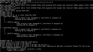

                 config result:

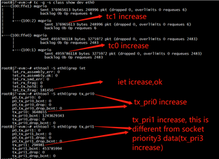

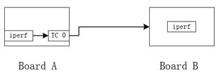

             I did the following  six tests,The results are as follows:
        Test 1:
                         Board A: iperf3 -c 192.168.100.20 -u -b500M -l1472 -t300 -p5002
                  Board B:iperf3 -s -p5002
                        Check the result by running commands :
                        conclusion: this is what I expect,   iperf map to tc 0, and map to tx Queue 0
    Test 2:

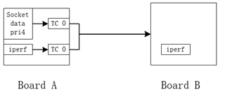

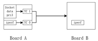

              board A socket priorit set code:
    int pri = 3;
    setsockopt(fd, SOL_SOCKET, SO_PRIORITY, &pri, sizeof(pri));
                  conclusion: this is not  what I expect,   socket data map to tc 1,But I'm not sure it's mapped to queue1 because tx_pri3 is growing

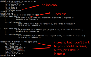

    Test3:
         conclusion: this is not  what I expect,   socket data map to tc 1,But I'm not sure it's mapped to queue1 because tx_pri3 is growing; iperf data map to tc 0, and map to Tx queue 0

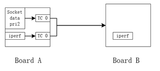

    Test 4:
          Board A socket priority set:
    int pri = 2;

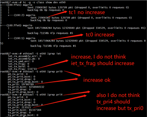

     conclusion: this is not  what I expect,   socket data map to tc 0,But I'm not sure it's mapped to queue0 because tx_pri2 is growing, and iet_tx_frag is growing ; iperf data map to tc 0, and map to Tx queue 0
        Assuming that socket data is mapped to Tx queue 0, why iet_tx_frag is growing?
    Test 5:
    int pri = 4;
    conclusion: this is not  what I expect,   socket data map to tc 0,But I'm not sure it's mapped to queue0 because tx_pri4 is growing, and iet_tx_frag is growing ; iperf data map to tc 0, and map to Tx queue 0

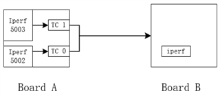

    Test 6:
        Board A add filter:
         tc filter add dev eth0 egress protocol ip prio 1 u32 match ip dport 5003 0xffff action skbedit priority 3
    I don't know that my understanding of this function is different from yours

    The skbedit and tc priority are different from the priority you assign using the SO_PRIORITY option. The SO_PRIORITY option maps to the hardware queues directly. Where as the skbedit and tc priorities map to specific traffic classes which in turn map to hardware queues. So if you want to match both these, then you would have to map the tc priority and traffic classes one-to-one.
    So, all your test results are correct and as I would have expected the mapping to behave.
    Hence, if you want this to work with both tc priority and SO_PRIORITY, then you would have to map priority 3 to tc 1 and to Tx queue 3. It won't be possible with Tx queue 1. The following configuration will work :
