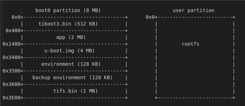

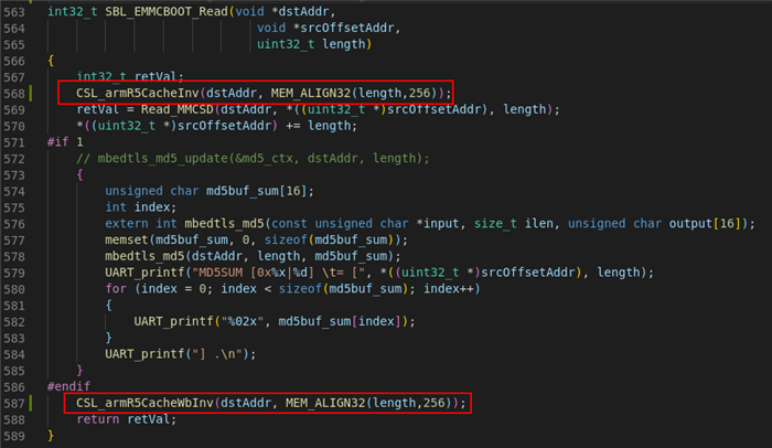

TDA4VM: An error occurs occasionally when the SBL loads the image From the eMMC.
Part Number: TDA4VM
Hi. Expert
SDK version: ti-processor-sdk-rtos-j721e-evm-07_03_00_07
eMMC:Samsung Electronics KLMBG4GEUF-B04Q057
We have made the following modifications to SBL with reference to this link:
1).Enable boot partition and load firmware from boot partition.
2).Unused file system.
register:
MMCSD0_SS_PHY_CTRL_4_REG=0x106000
MMCSD0_SS_PHY_CTRL_5_REG=0x0
By comparing the MD5 value, it is found that the MD5 value changes when the startup fails,
Can you provide me with some troubleshooting ideas?

    +#define BOOT_EMMC

    +int32_t SBL_EMMCBOOT_Read(void *dstAddr,
    +                             void *srcOffsetAddr,
    +                             uint32_t length)
    +    int32_t retVal;
    +    retVal = Read_MMCSD(dstAddr, *((uint32_t *)srcOffsetAddr), length);
    +    *((uint32_t *)srcOffsetAddr) += length;
    +#if 1
    +    // mbedtls_md5_update(&md5_ctx, dstAddr, length);
    +        unsigned char md5buf_sum[16];
    +        int index;
    +        extern int mbedtls_md5(const unsigned char *input, size_t ilen, unsigned char output[16]);
    +        memset(md5buf_sum, 0, sizeof(md5buf_sum));
    +        mbedtls_md5(dstAddr, length, md5buf_sum);
    +        UART_printf("MD5SUM [0x%x|%d] \t= [", *((uint32_t *)srcOffsetAddr), length);
    +        for (index = 0; index < sizeof(md5buf_sum); index++)
    +            UART_printf("%02x", md5buf_sum[index]);
    +        UART_printf("] .\n");
    +#endif
    +    return retVal;

    eMMC layout:
    BR
    xin he
  • Hi Xin He,
    Could it be something related to cache? Can you try invalidating cache before calculating MD5 checksum?
    Brijesh
  • Hi Brijesh,
    Is that right? However, MD5 verification errors still occasionally occur.
    BR
    xin he
  • Hi xin he,
    By any change, are you calculating md5 checksum on the size, which is aligned to sector size? Because image size may not be aligned to sector size. For example, the size of the tifs.bin file in SDK8.2 is 263,083 bytes, which is not aligned to 512byte sector size. So if you are calculating MD5 checksum on 263,168 size, it will not match and can vary..
    Brijesh
  • Hi Brijesh,
    Sorry, you may have misunderstood md5sum here.
    I am not calculating the md5sum of a file,This is a callback function that calculates the md5sum after each read of eMMC.
    Without updating the boot partition, md5sum will change if there is a boot failure.Judge through md5sum that the data has been tampered in the process of reading from eMMC to DDR.
    The problem now is to help me find out what causes the file read by EMMC to be tampered with.
    Sika lu(FAE Engineer in TI China),He suggested that I modify the register according to the datasheet "mmc0 DLL delay mapping for all timing modes" table.I can't start normally in HS200 and HS_DDR mode after modifying according to the register on the table,other modes are consistent with the above phenomena.
    BR
    xin he
  • Hi Brijesh,
    It's a DDR problem. We modified the configuration of DDR to solve this problem.
    xin he
