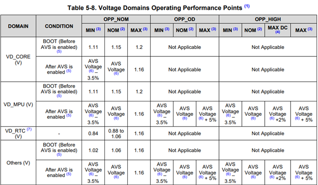

    By the way, about "The max voltage is defined as 1.2 V on VD_MPU and VD_CORE;"
    According to SPRS957I, the maximum value of VDD_MPU is 1.25V when using OPP_HIGH, according to Table 5-8 and note (6). Is that correct?

  • Hello Kadowaki,
    Latest datasheet version does confirm OPP_HIGH maximums to be 1.2V for VD_CORE/VD_MPU:

    We have also seen the table you provided, but we have two questions.
    Q1: Isn't the maximum voltage "1.25V" instead of "1.20V"?
     According to note (6), the AVS voltage at OPP_HIGH is 1.05--1.25V.

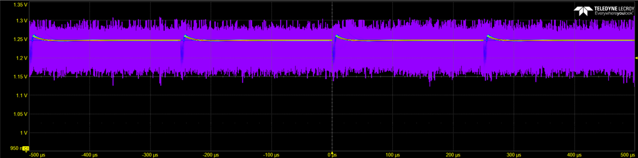

    In fact, our set is operating at 1.25V when AVS is set. (Please check the wevwform below.)
    Also, We tried to set 1.26V and 1.27V in the voltage change confirmation, but We could not set it to those voltages.
    Q2: Can't the AM5716 to TPS65916 (PMIC) be set to 1.26V or higher?

  • Kadowaki-san,
    @OPP_HIGH:
    VD_CORE: Max at boot: 1.2V
                       Max after enabling AVS: 1.16V
    VD_MPU: Max at boot: 1.2V
                     Max after enabling AVS: AVS Voltage + 5%

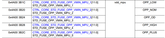

    The AVS voltage level specific to the device can be read from the STD_FUSE_OPP Registers, and should be within the range 1.05-1.25V. Please see below for VDD_MPU OPP_HIGH register/bitfield to read (taken from TRM).
    Please confirm what this value is read as. STD_FUSE_OPP_VMIN_MPU_4 + 5% should be the value configured on the PMIC, and my understanding is that this value should not exceed 1.25V.

    We checked the register (STD_FUSE_OPP_VMIN_MPU_4) and it is 1.25V (0x04E2).

    Q1: From the above results, We understand that the maximum voltage of AVS has been reached, so we cannot raise the voltage.
           Is this understanding reasonable?
    Conversely, I set VDD_MPU to 1.05V, but the symptoms did not change.
    This led us to recognize that the symptoms of errata i878 are independent of DC voltage.
    However, the increased capacitor capacity of the VDD_MPU and the enhanced board wiring of the VDD_MPU (referred to SPRAC 76 D in the application manual) improved the symptoms of the problem.
    We will proceed with the design with this countermeasure.

  • Hello Kadowaki-san,
    Thank you for confirming that information.
    As for setting the voltage higher than the specified maximum, it is most probably being blocked in software (despite the PMIC being able to supplying voltages higher than 1.25V). This could be disabled, but adjusting capacitance is the more straightforward route.
    The app note on power distribution networks you mentioned (SPRAC76D) is certainly a good resource to use, as improved routing and capacitor selection would be the next debug steps here anyway. Violating PDN guidelines can cause voltage dips from capacity issues or noise to happen.
