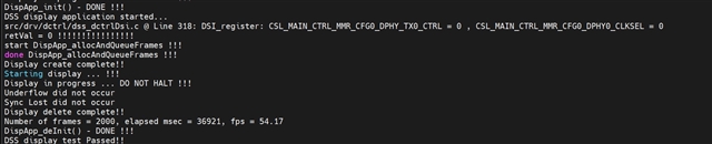

  • Hi Brijesh,
    Boot from SD card. log as below. Probe on UB941 DSI-pin clk & data-lane0/1, None of them have a waveform !!!!!
    DispApp_init() - DONE !!!
    DSS display application started...
    src/drv/dctrl/dss_dctrlDsi.c @ Line 318: DSI_register: CSL_MAIN_CTRL_MMR_CFG0_DPHY_TX0_CTRL = 0 , CSL_MAIN_CTRL_MMR_CFG0_DPHY0_CLKSEL = 0
    Display create complete!!
    Starting display ... !!!
    Display in progress ... DO NOT HALT !!!
    Underflow did not occur
    Sync Lost did not occur
    Display delete complete!!
    Number of frames = 2000, elapsed msec = 36921, fps = 54.17
    DispApp_deInit() - DONE !!!
    DSS display test Passed!!
    So tried to use CCS-Debug to load a image. Encountered this issue <required to update xds110 firmware>!

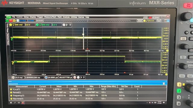

    In fact, Both Boot From SD Card and debugging on CCS are aimed at one purpose to probe TDA4 DSI output data format Whether it contains the required information<VSA+VBP+VFP>.
    Murphy
  • Hi Brijesh,
    Here is the DSI-Tx test waveform & log !
    Murphy
