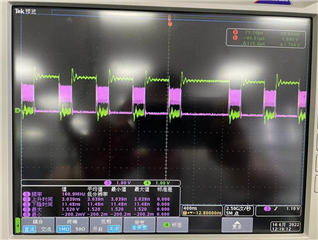

We are using DRA821 UDMA to load a large mount of code in NorFlash to RAM during the initialization, and we found it took much more time than we expected.
Following is the signals of CS and data line captured by oscilloscope. The green signal is CS, and the purple one is data line. We consult the NorFlash provider(IFX, s28hs512t) that there shall be a minimum interval between every read command called dummy cycles, and as shown in below figure, there are two many dummy cycles which result in low usage of data transformation. In other words, we want to increase the data length of every read command, which can significantly reduce the "idle" time between each read command.
However, we can't find the way to configure it. For UDMA, we can only configure UDMA read total size which the size of whole software code, and the UDMA utilizes OSPI DAC mode to direct access NorFlash.

    For the scope capture, pic1 is the data transfer during one CS pull-down cycle, could you please tell us how many data is transferred?
    there is a lot of potential not fully utilized.
    If we increase the size of transferred data every command(CS(every blue) line pull down cycle),
    the data transfer time can be largely decreased, as seen in pic2
    Thank you !

    Can you please point me to the exact signal which is clock and data in the scope captures you have shared. Both the pictures look like CS vs data.
    The time between two consecutive CS low states is the time gap between two flash read API calls, but not the dummy cycles. Have you tried increasing 'maxReadNormalMode' beyond 1024 in your flash configuration and see if it makes any difference?

    also on the scope shot, can you zoom-in and count how many clock interface cycles when CS is asserted.

  • Both the pictures are CS and clock during udma transfer from NorFlash to DDR.
