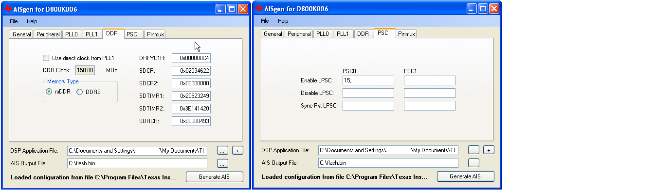

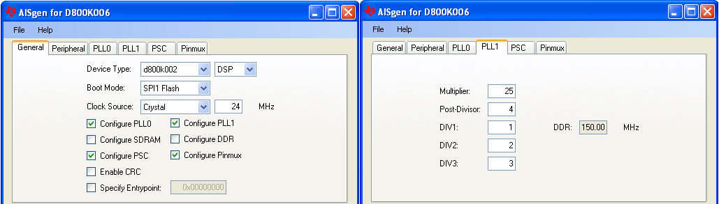

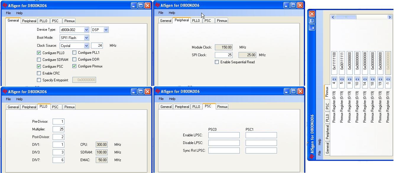

  • Yo Eric of the Wilbur tribe,
    From viewing the AISgen program, I suspected it can replace both the .GEL file and the NO_GEL coding in the software.  But I wasn't entirely sure, until you told me. The NO_GEL approach sure seemed easy, as it didn't require any deep knowledge on my part -- just flip the switch and it's done.  Or so I thought.  Now I see the AISgen program can do this same function.
    The question then is how to config the AISgen program. I must get a lot of parameters from somewhere. To do a "diff", or to copy over the .GEL setting to the AISgen,  would require me to dig into a bunch of .gel code, which is pretty ugly.  (Have you read one of those .gel files?  It will roll the eyes back in your head...)
    You refer me to a .pdf file -- I assume that's this one.  Those instructions are super helpful.  Though I have three comments:
    1. Under the AISgen Peripheral tab, I cannot get it to match your screen capture images.  That is, I get:  Module Clock=150.00 MHz,    SPI Clock 50 = 50.00 MHz.  Try it!
    2. When finished configuring AISgen, you may want to recommend we save the config file somewhere.  (I assume we should save it in the same directory with the AISgen.exe file  ?)
    3. Perhaps I don't understand the navigation yet, but I often have trouble locating the proper wiki pages.  It's almost like a separate website, with few links to it from your main ti.com website.  And when I try a "search" for it, the search engine drowns me with lots of cryptic references that I must plow through to find what I'm looking for.  The process of getting to the wiki pages could be smoother.
    This just in:  I tried the above method, and the console reports failure.

  • Ok, so my middle name is FUBAR - are you sure you want to continue getting help from me?  ;-)
    Yes, I have looked at many GEL files. They can be cryptic. But, if you look at the DDR2 settings, for example, they are identical to what you place into the DDR2 settings in the AISgen config file. Yes, it takes a little work, but it beats looking through the data sheets. Although, if you want to CHANGE these settings to something else, well, you're back to the datasheet. Heads sometimes have to spin a bit.
    The pdf you linked to is correct. Although, it is the procedure for the ARM+DSP (OMAP-L138) flash boot. But, this was updated as well to include ALL of the AISgen settings. So, you can combine the procedure for the C6748 and the AISgen configuration from the OMAP-L138 procedure.
    Which AISgen are you using? I am using 1.7c. Are you sure you determined your silicon rev correctly (via the instructions in the pdf)?
    Wow - you caught ANOTHER error on my part. It sure is nice to have someone like you going through these procedures and fixing them for me. ;-)  Try Module Clock = 150MHz as before, but put in 25MHz for the SPI clock. 40MHz might be overclocking it. When I looked at my configuration, I used 25MHz. Not sure where that screen cap came from - but it was certainly ME that put it there. Try 25MHz and see if that works.
    I added the hint to save the .cfg file in a folder. If you download the labs/solution files from that wiki, you can even use the .cfg file I have already filled out for you.

  • Eric,
    Your advice is very helpful, and I feel like I'm close to success.
    I'm using AISgen v1.7c, and I'm sure I correctly determined my silicon rev (from using the debugger to look at the DSP memory address) and set it in AISgen.  I'm following all the directions carefully.
    Here is another mystery.  I have two boards:  The LogicPD EVM board, and a target board (on which LogicPD had a hand) -- and I'm using the same c6748 SOM on both boards (literally moving it physically back and forth between the two boards).  The LogicPD EVM board has an onboard XDS100v1 emulator, while the target board has an off-board XDS100v2 emulator.  All that looks good.
    And I figure I should be able to flash the memory using the same method for either board.  (Same SOM with the same flash memory.)  But for some reason, I can successfully flash the SOM on the EVM board, but not on the target board.  Any ideas why?
    And despite the successful flashing of memory, my software still isn't running, even though it ran fine when loaded from the debugger.  I'm baffled.

  • For the LogicPD c6748 SOM, should the AISgen config file select (and then specify) mDDR or DDR2?
  • All LogicPD SOMs come with mDDR, so please chose mDDR and not DDR2

  • I have questions about the "AISgen for D800K006" software, particularly the PSC tab.  It don't know how to set the parameters in this tab, and I can't find documentation on it.

  • I have questions about the AIGgen tool (known peculiarly as "AISgen for D800K006").
    I am using the LogicPD C6748 SOM, and the following two screen shots show my current settings of concern.  Am I setting these correctly?  (I can't locate a manual for this AIGgen tool. So I'm in the dark.)
  • On the PSC screen delete the text "15;" so that the box is empty.  That way the boot ROM will not mess with the PSC in terms of turning on the DSP.  Can you post screenshots of ALL the screens?  In particular I wanted to see the main/General screen, but probably seeing all of them would be good.  Make sure you have selected the corrected boot ROM revision.
  • Similarly, on the general tab, remove the check from the "Configure DDR" option to disable the code that does that during boot.
  • Here is a screen capture of the parameters used in my latest (failed) attempt to flash the C6748 SOM.  What am I doing wrong?

  • CORRECTION:  I noticed that PLL1 had somehow come unchecked.  So I ran everything again, this time the same as above, except with the correction to the two screens captured here.

    I see you are still getting an invalid opcode error.  As Daniel mentioned the writer utility will verify the code has been written properly.  Therefore it would seem the code has been burned properly.  That said, there could still be an issue in the READING of the AIS image due to the fact that you are reading the image at a different speed than you are writing the image.  In particular I see the SPI is configured to operate at 25 MHz.  I haven't looked at the data sheet for the device you are using, but often 25 MHz is on the edge of what these SPI flash devices can handle.  That said, I recommend creating a new image and setting that speed much lower, perhaps 5 MHz for now.
    One other thing to try is the "enable sequential reads" option for the SPI.  So can you please do the following:
    • Reduce the SPI clock speed to 5 MHz in the GUI.
    • Burn your new image.
    • See if it works, post the corresponding gel output.
    • Turn on the "enable sequential reads" option.
    Brad
  • Mastermind Brad,
    I did the two test that you instructed:  5 MHz SPI clock, without and then with the "enable sequential reads" option.
    The console reports are both within the attached file.
