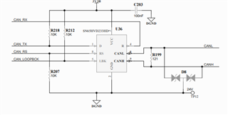

We are trying to bring up CAN 2.0 on our AM335x MPU. However, we are not able to establish CAN communication using CAN-USB Peak CAN adapter connect to a host.
When we probe the CAN Transceiver Tx line while sending a "cangen can0" from the Linux command line, we see no activity on r Tx line.
Similarly, when we send can messages from our PEAK View App on the host pc to the board, we are able to see acitivity on the Rx line of the receiver but "candump can0" returns no messages.
Our CAN transceiver configuration can be found below:

We are initializing our can0 bus with the following commands:
ip link set can0 type can bitrate 500000
ip link set can0 up
We also make sure the loopback pin is low, by manually setting the gpio0[15] to 0 through /sys/class/gpio

    Could you please describe your system or attach a block diagram?
    Schuyler
    We are not using a Linux SDK. The Linux version is mainstream 5.10 not a TI version.
    We have 1 CAN controller over SPI which working fine. (Ignore this one)
    And we have 1 CAN transceiver connected to the Sitara through the Sitara DCAN0 can interface.
    On the left you have the can connections going to the AM335x chip and on the right the actual Can transceiver.

    Please attach the results to these commands. It looks like the driver is correct but as you point out no traffic on the TX line. The first command will show the state of the line.
    ip -d -s link show can0
    cat /proc/net/can/stats
    Best Regards.
    Schuyler
