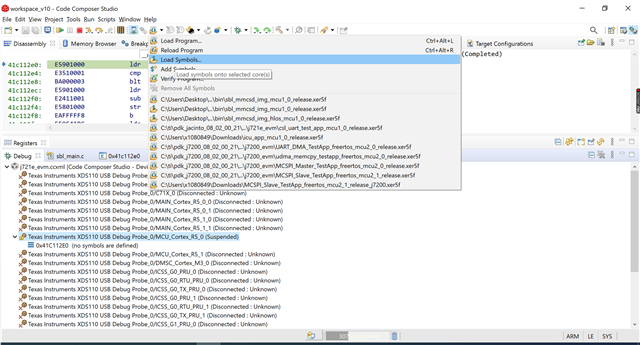

    In order to single step through SBL, please follow the below steps:

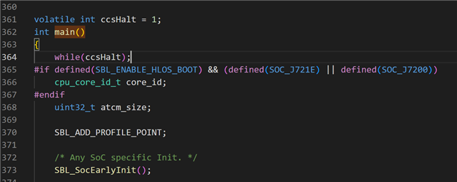

    1) Modify the SBL
    Modify the main() function in <PDK>\packages\ti\boot\sbl\board\k3\sbl_main.c to add an infinite while loop. Create a volatile variable and loop on it at the start of the main function.
    2) Build SBL in debug mode
    Please refer to the FAQ to see how to build SBL for debugging here

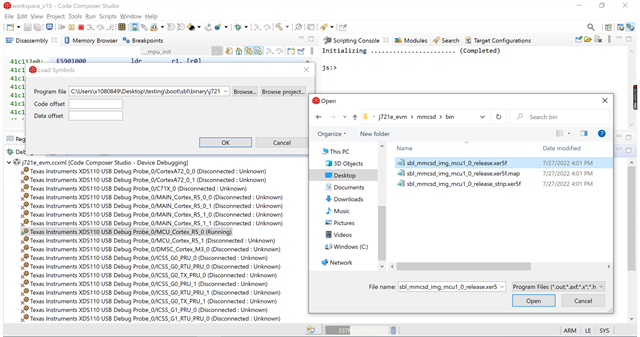

    3) Connect to CCS and single step
    Once the SBL is built in debug mode with above changes. Put the SBL is relevant boot media and boot. Then connect to the MCU R5F core. Make sure you don’t run any gel script or the launch.js
    Once the R5F is connected, load the symbols. Once you load the symbols you should see the target halted at while(ccsHalt) loop we created above. If you don’t see target halted, it means RBL is not able to load SBL, please go to the previous step and ensure everything is correct.
    If you see the target halted at the while loop, change the value of ccsHalt variable from 1 to 0. Then, you should be able to single step through the SBL all the way to app.
    Single stepping through SBL will help you figure out if there are any issues with the SBL
    Note: Please note that the DMSC Watchdog will reset if the system is held in the while loop for more than 3 minutes. This is because TIFS will pet the DMSC watchdog and if that is not loaded within 3 minutes, the SoC will reset.
