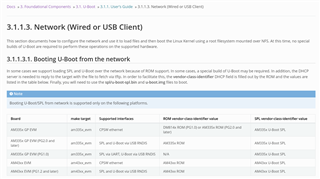

I have a BeagleBoard derivative and have followed the documentation provided in the SDK to enable loading the SPL and u-boot from a TFTP server. Here are the relevant excerpts from the documentation:
From the wireshark logs, I'm able to see that the BOOTP requests are happening and the u-boot-spl.bin file is fetched and served. The console output shows:

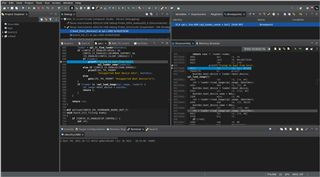

Ive been able to trace the code execution up to this point with JTAG and CC.
I believe the last function that's called before it hangs and goes into a reset is spl_load_image(). If I continue execution from the point in the image above and then pause a second or two later, this is the disassembly I see:
Any guidance for further debug steps would be greatly appreciated -- thanks!

    If the above fails, I would re-try the above on an actual BeagleBone Black board, to see if there might be a HW concern/incompatibility with your custom board.
    Then, since you already have the debugger up (great!) can you see if you can step from SPL into U-Boot, to see if it got loaded, and at least executes the first few instructions correctly?
    You can also try adding a #define DEBUG statement to the top of the common/board_f.c and common/board_r.c files, that should yield additional debug outpout.

    I actually had complete Ethernet (and USB-Ethernet) based boot working a while ago, you can find all the info in this E2E threads: https://e2e.ti.com/support/processors-group/processors/f/processors-forum/894702/am3358-beaglebone-black-am3358-emmc-not-flashing-from-usb-ethernet
    One of the posts on that thread has an attachment with files of the eMMC flasher solution I developed (a superset of what you need), and has the following comment in the included readme file.
    # Populate pre-built U-Boot images from SDK into TFTP folder
    # Note, we can use the pre-build U-Boot images as-is, no modifications needed!
    adannenb@beast:/opt/ti-processor-sdk-linux-am335x-evm-06.03.00.106
    $ cp -v board-support/prebuilt-images/{u-boot-spl.bin-am335x-evm,u-boot-am335x-evm.img} ~/tftpboot/
    Note how it says the pre-build U-Boot images part of the SDK work as-is for Ethernet-based boot. But this was with SDK v6.03. So it may be possible there was some regression and this no longer works as it used to be. To find out, you can go back to the previous SDK versions to try the pre-built files from there:
