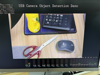

I'm sure the paths to the relevant files are all correct.
But there were none objects detected after transform.The image is as below.

    But the generated image is still empty.(image name tidl_import_yolox_s_lite_640x640_20220221_model.txt_stats_tool_out.bin_ti_lindau_000020.bmp_000000_tidl_post_proc2.png)
    I am confused.

  • Hello Manu:
    I have solved my problem.
    There are several parameters of the impoter file that need to be modified.
    quantizationStyle  = 3
    inScale = 1.0 1.0 1.0
    metaArchType = 6
    And the impoter for yolox file is as below :

    outputParamsFile = "../../test/testvecs/config/tidl_models/onnx/yolox_m_ti_lite_45p5_64p2/tidl_io_yolox_m_ti_lite_45p5_64p2_"
    inDataNorm = 1
    inMean = 0 0 0
    inDataFormat = 1
    inWidth = 640
    inHeight = 640
    inNumChannels = 3
    numFrames = 1
    inData = "../../test/testvecs/config/detection_list.txt"
    perfSimConfig = ../../test/testvecs/config/import/device_config.cfg
    inElementType = 0
    #outDataNamesList = "convolution_output,convolution_output1,convolution_output2"
    metaArchType = 6
    metaLayersNamesList = "../../test/testvecs/models/public/onnx/yolox_m_ti_lite_metaarch.prototxt"
    postProcType = 2
    And the url of the TI yolox onnx is :TI yolox onnx and prototxt
    Also , I post a thread in our forum. Click hereYolox run On TDA4 EVM
    Good luck !
  • Good to hear that.
