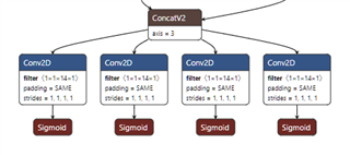

I have trying to convent a propaietary from netowk to tidl.
my network has the below outputs:
Howver, the tidl adds the below layers(31 and on) aftewards(log from tidl_model_import.out)
27|TIDL_ConvolutionLayer |conv2d_9/Conv2D | 0| 1| 1| 26 x x x x x x x | 27 | 1 14 32 64 | 1 1 32 64 | 28672 |
28|TIDL_ConvolutionLayer |conv2d_10/Conv2D | 0| 1| 1| 26 x x x x x x x | 28 | 1 14 32 64 | 1 1 32 64 | 28672 |
29|TIDL_ConvolutionLayer |conv2d_11/Conv2D | 0| 1| 1| 26 x x x x x x x | 29 | 1 14 32 64 | 1 1 32 64 | 28672 |
30|TIDL_ConvolutionLayer |conv2d_12/Conv2D | 0| 1| 1| 26 x x x x x x x | 30 | 1 14 32 64 | 1 1 32 64 | 28672 |
31|TIDL_BatchNormLayer |lower_eyelid/Sigmoid | 0| 1| 1| 27 x x x x x x x | 31 | 1 1 32 64 | 1 1 32 64 | 2048 |
32|TIDL_BatchNormLayer |upper_eyelid/Sigmoid | 0| 1| 1| 28 x x x x x x x | 32 | 1 1 32 64 | 1 1 32 64 | 2048 |
33|TIDL_BatchNormLayer |pupil/Sigmoid | 0| 1| 1| 29 x x x x x x x | 33 | 1 1 32 64 | 1 1 32 64 | 2048 |
34|TIDL_BatchNormLayer |iris/Sigmoid | 0| 1| 1| 30 x x x x x x x | 34 | 1 1 32 64 | 1 1 32 64 | 2048 |
35|TIDL_DataLayer |lower_eyelid/Sigmoid | 0| 1| -1| 31 x x x x x x x | 0 | 1 1 32 64 | 0 0 0 0 | 0 |
36|TIDL_DataLayer |upper_eyelid/Sigmoid | 0| 1| -1| 32 x x x x x x x | 0 | 1 1 32 64 | 0 0 0 0 | 0 |
37|TIDL_DataLayer |pupil/Sigmoid | 0| 1| -1| 33 x x x x x x x | 0 | 1 1 32 64 | 0 0 0 0 | 0 |
38|TIDL_DataLayer |iris/Sigmoid | 0| 1| -1| 34 x x x x x x x | 0 | 1 1 32 64 | 0 0 0 0 | 0 |
My conversion has  two issue:
1. when runnig with trace, i see that the last layer that rertun meaningfull data is layer 30. from layer 31 all outputs are 0.
2. when running with the library ioBufDesc->outElementType[id] return 2 instreat of 6(float32)
