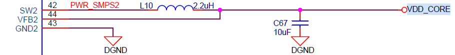

  • Hi Andreas,
    That is not really a valid way to capture the the VDD_CORE current as you are capturing the operation of the SMPS itself as it regulates and tries keeping the voltage at the capacitor constant by way of modulating the charging of the inductor, so it is expected for this current to fluctuate (actually it should fluctuate across some baseline value and NOT go to zero --> there may be some issue how you are measuring this current).
    Could you also point us where is the correct place to measure VDD_CORE current?
    For example in below schematics, VDD_CORE current should be measured at SoC side after C67?
    Thanks and regards,
    Koichiro Tashiro
  • Could you also point us where is the correct place to measure VDD_CORE current?
    Yes, correct. The current needs to be measured on the SoC side of C67.

    but TI local FAE Tashiro-san will send the report to you by email, so could you please check the report.
    best regards,
    g.f.
  • The customer already tried this experiment and the result was successful.
    They supplied 1.2V externally to VDD_CORE of the failing board and the board have booted successfully.
    Oh this is great to hear they ran this experiment already, I think that really pins the problem to the power supply then. I suggest we stop investigating the memory setup for now and re-focus back on power supply concerns.
    What I would suggest as a next step is to provide schematic and PCB layout offline to TI via Tashiro-san so we can have our HW team do a detailed review.
    Regards, Andreas
  • Hi Andreas,
    Thank you for the reply.
    I understood to re-focus back on power supply concerns.
    I requested the schematic and PCB layout to my customer, so please wait for a while.
    By the way, we understood to re-focus back on power supply, but could you also tell us the detailed steps to make "memtester" support in TI Linux version 4.14.67 for future use case? Because my customer are requesting the detailed steps.
    best regards,
    g.f.
  • I requested the schematic and PCB layout to my customer, so please wait for a while.
    We received the files and I provided them to our HW team for a detailed review, thanks. Will update the result hopefully next week.
