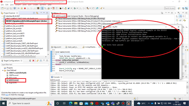

  • Thilak,
    I am able to test the MCBSP on the K2G EVM using the sample project, "MCBSP_DigLpbkevmK2Gc66ExampleProject" in the processor SDK 6.3.
    Snapshot on the output logs in the uart console from the MCBSP sample program.
    The following are the steps, I did, to test and run the MCBSP Loopback test on the K2G EVM.
    1. Download and install, PROCESSOR-SDK-RTOS-K2G https://www.ti.com/tool/PROCESSOR-SDK-K2G
    2. Generate CCS PDK examples using the steps below.
    Once the PROCESSOR-SDK-RTOS-K2G is installed, observe the PDK package,  "pdk_k2g_1_0_16" under C:\ti
    1. Launch command prompt
    2. Go to the directory C:\ti\pdk_k2g_1_0_16\packages
    3. Run pdksetupenv.bat
      1. C:\ti\pdk_k2g_1_0_16\packages>pdksetupenv.bat
    4. DSPCore examples:
      1. C:\ti\pdk_k2g_1_0_16\packages>pdkProjectCreate.bat K2G all little all all dsp "C:\ti\pdk_k2g_1_0_16\packages"
    5. ARMCore examples:
      1. C:\ti\pdk_k2g_1_0_16\packages>pdkProjectCreate.bat K2G all little all all arm "C:\ti\pdk_k2g_1_0_16\packages"
    6. It will create a folder by name "MyExampleProjects" under C:\ti\pdk_k2g_1_0_16\packages.
    7. You will find the list of example projects getting created. ( approximately, the total will be - 92 examples )
    3. MCBSP_DigLpbkevmK2Gc66ExampleProject will be one among them.
    4. Import the MCBSP loop back project into CCS and run on K2G EVM.
    Connection and hardware setup:
    1. DIP Switch settings : - Boot Mode SEL - SW3 - 00000 - No boot mode - For CCS
    2. Connect Mini usb cable between the XDS USB port on the EVM and the PC-usb port.
    3. Connect Mini usb cable between the USB-uart port  on the EVM and the PC-usb port.
    4. Disable the DB9 uart switch settings - SW12.
    4. In PC, open the device manager and detect the COM port number for the USB-uart connection and feed it in Teraterm or putty.
    Please have a look at the video on how to run on K2G EVM.
    Shankari G
