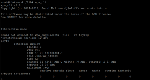

  • Ok then I am assuming the drivers will load automatically. But what commands do i use to connect it to a Access point?

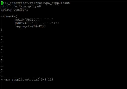

    I tried wpa_cli which gives a cli to connect but it is not supported. Then i checked with iw dev command. And the  wifi module seems to be in AP mode. Any suggestions on how  to supply the wifi passphrase and name? I tried to manually add a entry in wpa_supplicant.conf but that also did not help.

    Step 1: When you boot the board . The wifi module is in AP mode.
    Step2: Connect over UART and first disable the interface
    • sudo ip link set wlp1s0 down
    step3: Now you can change the mode of wifi Module  from AP to "Managed" using  the following command.
    • sudo iw wlp1s0 set type managed

    Step6: Now we pass our wifi SSID and credentials to wpa_supplicant.conf
    • wpa_passphrase <name_of_my_ssid>  <my_password> | sudo tee /etc/wpa_supplicant.conf
    step7:  Enfore connection. Please note  that if you dont use & then you will not be able use the terminal. & makes the command run in background. But the outputs will still be shown on your console. You can also reroute the outputs to another null interface. Search for that yourself.
    • sudo wpa_supplicant -c /etc/wpa_supplicant.conf -i wlp1s0 &
