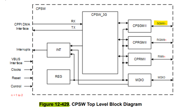

Hi team,
Good day! We need your help. AM62x processor in Technical Reference Manual of Figure 12-429. CPSW Top Level Block Diagram. shows that AM62x processors have SGMII, Kindly please check and confirm AM62x processors support SGMII or not?
AM62x Processors Silicon Revision 1.0 Texas Instruments Families of Products (ti.com)
Thank you in advance.
  • Hello Jonathan Navor
    Thank you for the Query. The Block diagram you are refereeing to seems to be a generic diagram used across devices.
    Please refer below referenced block diagram Figure 12-425. CPSW0 Overview
    The supported features and detailed interface diagrams are provided in the below section.
    12.3.1.1.1 CPSW0 Features
    The 3-port CPSW0 subsystem provides the following features:
    • Two Ethernet ports (port 1 and 2) with selectable RGMII and RMII interfaces and an internal Communications
    Port Programming Interface (CPPI) port (port 0)
