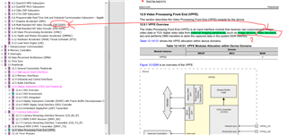

TDA4VM: What is the meaning of “image sensors” in TDA4VM datasheet “12.9 Video Processing Front End (VPFE)”
Part Number: TDA4VM
Other Parts Discussed in Thread: TVP5147
Hi TI Expert
Can you explain something for me?as following:
1)red cycle decoder stands for "6.8 Multi-Standard HD Video Decoder (DECODER)"
2)what about the red cycle " image sensors"? could you tell me "image sensors" meaning ?
    Here the video decoder mean decoders like TVP5147, which can receive analog input an can convert into decoded digital output..
    and sensor means, the sensor which can output raw data, like raw12 bit bayer data.
    Btw, VPFE block is not supported in the SDK. We recommend using MIPI/CSIRX input as capture module.
