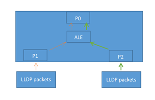

CPSW working mode is switch.
LLDP packets are broadcast packets, and the current project needs to send them to the specified port.
LLDP packets received by P1 are only forwarded to P0
LLDP packets received by P2 are only forwarded to P0
LLDP packets sended by P0 are only forwarded to P1 or P2
How to configure CPSW related registers?

  •                                         Figure 1
                                       Figure 2
    I configured it as shown in Figure 2, but it didn't work。
    Do it need other configurations?
    Are you using this link from the SW developer's guide to configure  the CPSW ALE?
    Could you show the steps that you did to setup the CPSW?

    After looking at this again are you using VLANs in the switch config commands based on the diagram posted at the beginning of the thread? This diagram is showing how dual mac mode is implemented in the switch. Please try the command again with VLAN ids.
    Schuyler
  • I do not configure VLAN for dual mac.
    My functional requirements:
    LLDP packets are broadcast packets, and the current project needs to send them to the specified port. The destination MAC of lldp packets is 01:80:c2:00:00:0e. Lldp packets without VLAN tag.
    1. CPSW working mode is switch.
    2. LLDP packets received by P1 are only forwarded to P0
    3. LLDP packets received by P2 are only forwarded to P0
    Whether the function can be realized, and if so, how to configure it
  • 4. Other data exchanges of P0, P1 and P2 cannot be affected, and the switch function needs to exist
