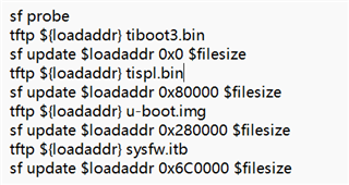

Hi TI team:
Based on project requirements, I want the board to boot from OSPI after flashing by dfu-util.
I followed the steps below,
And, I got logs,

~/auto_test/auto_test_project/tda4$
U-Boot SPL 2021.01 (Aug 08 2022 - 18:00:54 +0800)
Model: Texas Instruments J721E SK R5
Board: J721EX-EAIK rev A1
SYSFW ABI: 3.1 (firmware rev 0x0016 '22.1.1--v2022.01 (Terrific Llam')

It seems like everything's done successfully, but when I changed the start mode to OSPI and power on,  the board was not in u-boot and nothing print in the MAIN UART window even though I restarted the board for many times.
For reference, in the same board, with the same files, when I flashed the OSPI by following steps, it works, and the board could boot from OSPI.
Is there anything I did was wrong when I boot from OSPI after flashing by dfu-util? Could anyone give me some advice?
Thank you very much!

    In the meantime, the output of MAIN UART window is
    U-Boot SPL 2021.01-dirty (Jul 19 2022 - 17:23:02 +0800)
    Trying to boot from DFU
    ################################################DOWNLOAD ... OK
    Ctrl+C to exit ...
    init_env from device 18 not supported!
    Starting ATF on ARM64 core...
    NOTICE:  BL31: v2.5(release):08.01.00.006-dirty
    NOTICE:  BL31: Built : 21:03:57, Mar 23 2022
    U-Boot SPL 2021.01-dirty (Jul 19 2022 - 17:22:19 +0800)
    Model: Texas Instruments J721E SK A72
    cdns-usb3-peripheral usb@6000000: Unable to get USB2 phy (ret -61)
    cdns-usb3-peripheral usb@6000000: Unable to get USB3 phy (ret -22)
    cdns-usb3-peripheral usb@6000000: DRD version v1 (ID: 0004024e, rev: 00000200)
    cdns-usb3-peripheral usb@6000000: Initialized  ep0 support:
    cdns-usb3-peripheral usb@6000000: Initialized  ep1out support: BULK, INT ISO
    cdns-usb3-peripheral usb@6000000: Initialized  ep2out support: BULK, INT ISO
    cdns-usb3-peripheral usb@6000000: Initialized  ep3out support: BULK, INT ISO
    cdns-usb3-peripheral usb@6000000: Initialized  ep4out support: BULK, INT ISO
    cdns-usb3-peripheral usb@6000000: Initialized  ep5out support: BULK, INT ISO
    cdns-usb3-peripheral usb@6000000: Initialized  ep6out support: BULK, INT ISO
    cdns-usb3-peripheral usb@6000000: Initialized  ep7out support: BULK, INT ISO
    cdns-usb3-peripheral usb@6000000: Initialized  ep8out support: BULK, INT ISO
    cdns-usb3-peripheral usb@6000000: Initialized  ep9out support: BULK, INT ISO
    cdns-usb3-peripheral usb@6000000: Initialized  ep10out support: BULK, INT ISO
    cdns-usb3-peripheral usb@6000000: Initialized  ep11out support: BULK, INT ISO
    cdns-usb3-peripheral usb@6000000: Initialized  ep12out support: BULK, INT ISO
    cdns-usb3-peripheral usb@6000000: Initialized  ep13out support: BULK, INT ISO
    cdns-usb3-peripheral usb@6000000: Initialized  ep14out support: BULK, INT ISO
    cdns-usb3-peripheral usb@6000000: Initialized  ep15out support: BULK, INT ISO
    cdns-usb3-peripheral usb@6000000: Initialized  ep1in support: BULK, INT ISO
    cdns-usb3-peripheral usb@6000000: Initialized  ep2in support: BULK, INT ISO
    cdns-usb3-peripheral usb@6000000: Initialized  ep3in support: BULK, INT ISO
    cdns-usb3-peripheral usb@6000000: Initialized  ep4in support: BULK, INT ISO
    cdns-usb3-peripheral usb@6000000: Initialized  ep5in support: BULK, INT ISO
    cdns-usb3-peripheral usb@6000000: Initialized  ep6in support: BULK, INT ISO
    cdns-usb3-peripheral usb@6000000: Initialized  ep7in support: BULK, INT ISO
    cdns-usb3-peripheral usb@6000000: Initialized  ep8in support: BULK, INT ISO
    cdns-usb3-peripheral usb@6000000: Initialized  ep9in support: BULK, INT ISO
    cdns-usb3-peripheral usb@6000000: Initialized  ep10in support: BULK, INT ISO
    cdns-usb3-peripheral usb@6000000: Initialized  ep11in support: BULK, INT ISO
    cdns-usb3-peripheral usb@6000000: Initialized  ep12in support: BULK, INT ISO
    cdns-usb3-peripheral usb@6000000: Initialized  ep13in support: BULK, INT ISO
    cdns-usb3-peripheral usb@6000000: Initialized  ep14in support: BULK, INT ISO
    cdns-usb3-peripheral usb@6000000: Initialized  ep15in support: BULK, INT ISO
    Ctrl+C to exit ...
    U-Boot 2021.01-dirty (Jul 19 2022 - 17:22:19 +0800)
    SoC:   J721E SR1.1
    DRAM:  4 GiB
    Flash: 0 Bytes
    MMC:   sdhci@4fb0000: 1
    In:    serial@2800000
    Out:   serial@2800000
    Err:   serial@2800000
    am65_cpsw_nuss ethernet@46000000: K3 CPSW: nuss_ver: 0x6BA00101 cpsw_ver: 0x6BA80100 ale_ver: 0x00293904 Ports:1 mdio_freq:1000000
    Net:   eth0: ethernet@46000000port@1
    Hit any key to stop autoboot:  0
    => env default -f -a
    ## Resetting to default environment
    => setenv dfu_alt_info_ospi "tiboot3.bin raw 0x0 0x080000;tispl.bin raw 0x080000 0x200000;u-boot.img raw 0x280000 0x400000;sysfw.itb raw 0x6c0000 0x100000;rootfs raw 0x800000 0x3800000"
    => setenv dfu_alt_info $dfu_alt_info_ospi
    => dfu 0 sf "0:0:25000000:0"
    cadence_spi spi@47040000: Can't get reset: -2
    jedec_spi_nor flash@0: non-uniform erase sector maps are not supported yet.
    k3-navss-ringacc ringacc@2b800000: Ring Accelerator probed rings:286, gp-rings[96,20] sci-dev-id:235
    k3-navss-ringacc ringacc@2b800000: dma-ring-reset-quirk: disabled
    SF: Detected s28hs512t with page size 256 Bytes, erase size 256 KiB, total 64 MiB
    cdns,sierra serdes@5030000: sierra probed

    After that, we changed the start mode to OSPI and powered on, but the board did not go to u-boot and nothing printed in the MAIN UART window. So, we cannot provide log at this point.
    Thus, we changed the start mode to SD and powered on, and we used the command "hexdump mtdblock0" to check the OSPI flash and we got this

    We found that the data of address 0x0-0x20000 is lost (compared with the data burned by other methods).
    Please check for us, thank you very much!
