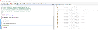

Importing, compiling and running the AM64x UDMA memcpy polling example fails to run (actually, all SDK dma examples fail in exactly the same place).  The example loops forever in the DebugP_assertNoLog() function with the following stack trace:
_DebugP_assertNoLog( 0 )
_clockSetFrequency()
PowerClock_init()
System_init()
main()
The actual failure is occurring in the Module_clockSetFrequency() function when calling SOC_moduleSetClockFrequency() with moduleID = 146, clkId = 0, clkRate = 96000000.  Stepping into the SOC_moduleSetClockFrequency() function reveals that the source of the problem is when that function tries to disable the clock before changing the frequency by calling  Sciclient_pmModuleClikRequest(), which returns -1.  The parameters passed to Sciclient_pmModuleClikRequest() are moduleID = 146, clkId = 0, TISCI_MSG_VALUE_SW_STATE_UNREQ, 0U, and SystemP_WAIT_FOREVER.

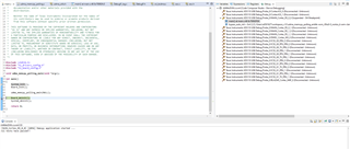

  • Hello James,
    I was able to recreate your issue.
    The A53 core is already using USART0 for debug logging and if we try to initialize the  same USRAT from the R5F core it will create an issue which you were observing.
    Please try to use USART other than USART0 in R5F core , in order to do that please use sysconfig and make changes in the system configuration as shown below
    I followed the following steps:
    1. I have placed the positions of sw2 and sw3 in the configuration below
    SW: S2 = 11000010, SW3 = 01000000
    2. The WIC image is loaded on the SD card
    3. SD card inserted in EVM
    4. Power on
    5. Open the example system config file and please change "UART Example" from USART0 to USART1
    6. Compile software
    7. Load binaries on R5F core.
    Finally I didn't face any problem and example software is running perfectly and there is no DebugP_assertNoLog assertion issue.
    Please let me know if this helps
    S. Anil
