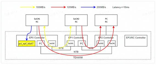

Referring to the SDK example, our customer wants to use below PCIe structure. TDA4VM is used as PCIe Backplane mode. Compared to the SDK example, the main difference is that there is a more function (they call pci_epf_tda4) used for receive data from SoC#1 in EP0 controller. SoC#1 and SoC#2 is other company's SoC.
Data path including:
  • SoC#1 => TDA4: 200MB/s
  • SoC#1 <=> SoC#2: 100MB/s
  • SoC#1 => PC: 120MB/s
  • SoC#2 => PC: 120MB/s
Their question is,
  1. Does TDA4VM PCIe support this structure? Can TDA4VM support these 3 NTB configuration?
  2. Can EP0 controller add this function (pci_epf_TDA4)? Do we have sample code for this function?
  3. Can SoC#1 send data to pcie_epf_tda4, PC and SoC#2 at the same time?
  4. If pci_epf_tda4 can be supported, what is the implementation form? Socket or lib? Can be virtual internet card?
  5. Can TDA4VM meet the bandwidth and latency (<=10ms)  requirement?
  6. To realize this function, does SoC#1 need 2 virtual internet card (one connect to SoC#2, another connect to PC)?
    [Sriram] Yes , TDA4 can support this configuration. We can model NTB port connections between J5#1/J5#2/PC and a direct RC to EP connection modelled as separate function “pci_epf_tda4”
    1. Can EP0 controller add this function (pci_epf_TDA4)? Do we have sample code for this function?
    [Sriram] We provide an EP test function that does a simple DMA from EP side to RC which can be used as starting point.
    But we have not included this alongside NTB use case, but I believe this should need configuration change largely.
    Kishon, can you provide pointers for this.
    [Kishon]: Both EP test function and NTB can be used simultaneously. Different physical function can be used for different usecases.
    1. Can J5#1 send data to pcie_epf_tda4, PC and J5#2 at the same time?
    [Sriram] Yes, J5#1 should see 3 independent functions (pcie_epf, NTB#1, NTB#2) and bind software on the RC accordingly
    1. If pci_epf_tda4 can be supported, what is the implementation form? Socket or lib? Can be virtual internet card?
    [Sriram]  this should be based on the intended usage model from J5 side.  PCIe acts only as  underlying transport and the actual interface is modeled by the “Function driver”  on either side
    [Kishon]: Right now we support simple communication form using pci_epf_test (https://git.kernel.org/pub/scm/linux/kernel/git/torvalds/linux.git/tree/drivers/pci/endpoint/functions/pci-epf-test.c). However upstream Linux also has a way for RC<->EP communication using ethernet
    https://git.kernel.org/pub/scm/linux/kernel/git/torvalds/linux.git/tree/drivers/pci/endpoint/functions/pci-epf-vntb.c
    1. Can TDA4VM meet the bandwidth and latency (<=10ms)  requirement?
    [Sriram] latency is usually in microsecond range for the individual data packets carried over PCIe.
    For bandwidth I assuming  the total traffic through TDA4M (including both directions) is 100+120+200 = 420MB/s or 3.360Gbps , which TDA can handle.
    Review to see if the connection to J5 is Gen2 vs Gen3 as the aggregate traffic needs to flow through this link.
    1. To realize this function, does J5#1 need 2 virtual internet card (one connect to J5#2 another to PC)?
    [Sriram] Connection to J5#2 and PC are modelled as NTB ports. There are additional abstractions/example(ntb_netdev, ntb_tool, ntb_perf) available in Linux that show communication model/usage over NTB shared memory region(although these may not be very efficient and use CPU to copy packets).
    Overall, PCIe provides a shared memory interface for remote core access(w/NTB). Depending on the nature of data to be exchanged, we should define the right SW abstractions on top of this.
    For instance if you are exchanging video/sensor data, it is better to build a PCIe function for this rather than taking video data and packetizing it to be sent as network packets
    Sriram

    Yes we should be able to leverage multi-function capability to model NTB connections to remote host and also include PCie Functions alongside
    Each connection to remote host would need one EP function. So following combinations all are possible on EP0 controller
    1. NTB:SOC#2 + NTB: PC + EP FN (local epf tda4)
    2. NTB:SOC#2 + NTB: PC + EP FN (local ethernet switch function mapped over PCIe to SOC#1)
    3. 2 above + EP FN (SSD connected to TDA4VM mapped as remote storage over PCIe to SOC#1)
    Sriram

    Since IP supports up to 6 physical functions, I don’t see a concern with adding one more function (pcie_epf_tda4).  However, it would be good to review the structure with systems as well since it involves multiple PCIe and SOC level architecture.
