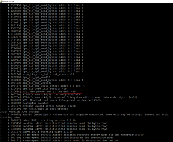

I have a problem to communicate TPM SLB9670 with AM6442-SK over SPI protocol.

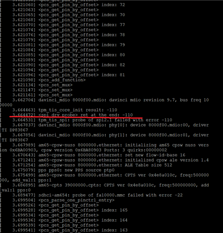

The problem is that although the TPM device is connected to the board, initialization of device fails. The tpm_tis_core_init () function returns the code -110 (ETIMEDOUT) or -19 (ENODEV). The result returned by this function depends on whether the MISO line to TPM is connected. If MISO is connected function returns -110, if not - then -19.

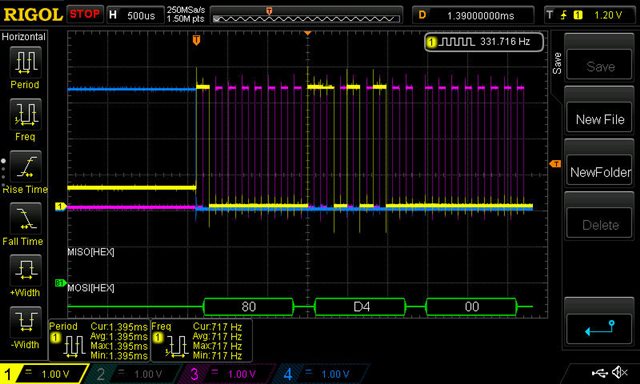

I also connected the oscilloscope probes to the appropriate pins. The waveform below indicates that a configuration message is being sent to the TPM. What's more interesting, if I connect the oscilloscope probe to the MISO pin, the tpm_tis_core_init () function returns -110, and if I do not connect the probe, it returns -19. This is a very strange behavior and it was detected on two same AM6442 boards.
 Below is kernel configuration and k3-am642-sk device-tree overlay:

I am using Yocto to build the image. I patched the tpm and spi driver to add some traces to have more verbose output. bellow screens:
How to resolve this problem?
