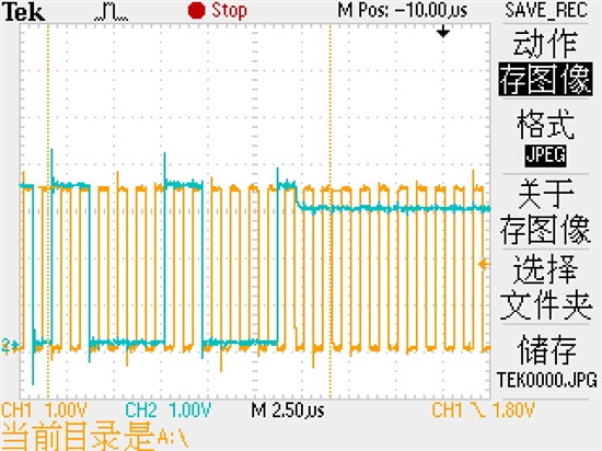

this is what we get form the oscilloscope:
the datasheet said that :
 The Management Data Input/Output (MDIO) module continuously polls all 32 MDIO addresses in order to
enumerate all PHY devices in the system.
 is it's signal suitable?

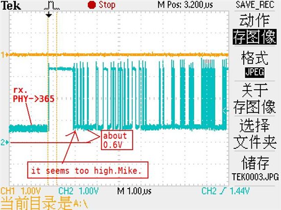

  • we had solved this problem. see the pic below:
    the green (ch2, the rx pins) get very high when it is in low level. about 0.6V and i think dm365 doesnot support such a high - low level input.
    after we tried with an other batch of this chip (same version:22,1512) it works.
    regards, Mike
