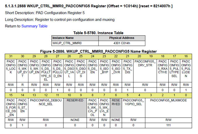

  • By the way, I find datasheet GPIO PINMUX register show as below:
    But this register show as TRM is wkup register. Is this information have any error?

  • Thanks. I have been able to reproduce the issue. I am checking internally on this. It seems to be something related to interrupt router configuration. I will keep you posted on this by mid next week.
    Keerthy
    Can you please add the below changes on top:
    diff --git a/arch/arm64/boot/dts/ti/k3-j721s2-main.dtsi b/arch/arm64/boot/dts/ti/k3-j721s2-main.dtsi
    index 57990eba5..dbd5ee283 100644
    --- a/arch/arm64/boot/dts/ti/k3-j721s2-main.dtsi
    +++ b/arch/arm64/boot/dts/ti/k3-j721s2-main.dtsi
    @@ -103,7 +103,7 @@
    #interrupt-cells = <1>;
    ti,sci = <&sms>;
    ti,sci-dev-id = <148>;
    - ti,interrupt-ranges = <8 360 56>;
    + ti,interrupt-ranges = <8 392 56>;
    main_pmx0: pinctrl@11c000 {
    diff --git a/arch/arm64/boot/dts/ti/k3-j721s2-mcu-wakeup.dtsi b/arch/arm64/boot/dts/ti/k3-j721s2-mcu-wakeup.dtsi
    index f31749ba9..c23fb6f7b 100644
    --- a/arch/arm64/boot/dts/ti/k3-j721s2-mcu-wakeup.dtsi
    +++ b/arch/arm64/boot/dts/ti/k3-j721s2-mcu-wakeup.dtsi
    @@ -65,7 +65,7 @@
    ti,sci = <&sms>;
    ti,sci-dev-id = <125>;
    - ti,interrupt-ranges = <16 928 16>;
    + ti,interrupt-ranges = <16 960 16>;
    Keerthy
