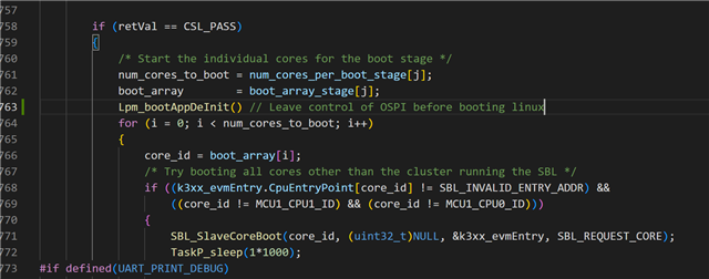

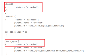

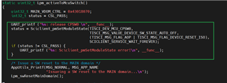

While testing lpm_example_freertos I have the following 2 issues:
1.After lpm_example_freertos  boot linux, Linux fails to load the ospi driver. mcu1_0 enter the ACTIVE mode again, lpm_example_freertos   fails to load the A72 image (fails to read the ospi data), and linux cannot be booted.Disable the linux kernel spi driver, and lpm_example_freertos   can read the ospi data normally.
2.When entering ACTIVE mode for the first time, Linux can load the eth0 driver. But when entering ACTIVE mode again, Linux fails to load the eth0 driver.
PS:the txt files are the boot logs.
 1.lpm 1st to acttive linux log(with spi driver).txt    => enter ACTIVE mdoe for first time Linux logs with spi driver
 2.mcu uart2 log.txt                                               => mcu1_0 logs
3.lpm 1st to acttive linux log(no spi driver).txt      => enter ACTIVE mdoe for first time Linux logs without spi driver
 4.lpm 2nd to active linux log(no spi driver).txt      => enter ACTIVE mdoe again Linux logs without spi driver
5.mcu uart2 log.txt                                                => mcu1_0 logs
