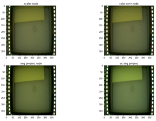

Color convert node(from openvx 1.1) -> Used this node from openvx 1.1 to check how the converted output should look like.
All of the above nodes are applied after the scaler node. So they are all compared to scaler node to identify how different they are from scaler node.
Looking at the images of the scaler node, colorConvertNode, imgPreProcNode, OCPreProcNode they seem very similar

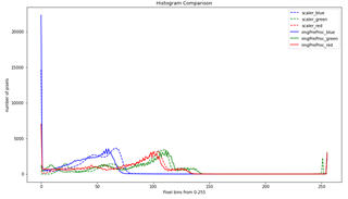

However, when the histograms are compared, there is good amount of difference.
Hist of scaler node vs imgPrepProcNode

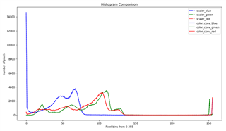

Hist of scaler node vs colorConvertNode

  • Hi Niranjan,
    There are two way of doing NV12 to RGB color conversion. In the VXLIB based color-convert it follows the below approach
    1. VXLIB based color-convert
        R'= Y' + 0.0000*U + 1.5748*V
        G'= Y' - 0.1873*U - 0.4681*V
        B'= Y' + 1.8556*U + 0.0000*V
    2. Whereas in PreProcNodes
     The below is used,
                            vx_int32 Y_  = Y - 16;
                            vx_int32 Cb_ = Cb - 128;
                            vx_int32 Cr_ = Cr - 128;
                            vx_int32 R = ((298 * Y_) + (409 * Cr_) + 128) >> 8;
                            vx_int32 G = ((298 * Y_) - (100 * Cb_) - (208 * Cr_) + 128) >> 8;
                            vx_int32 B = ((298 * Y_) + (516 * Cb_) + 128) >> 8;
    May I know which formula is used to create the histogram?
    Nikhil
  • Hi Nikhil,
    It is good to know the VXLIB based way to convert the yuv(nv12) to rgb.
    Let me clarify that the histogram was calculated on the PC. The outputs from the hardware were captured and then the histogram analysis was done in python using opencv functions(cv2.calchist).
    One of my plan is to replicate the calculations on the PC and see if I get the same result as the hardware. It might take time as I am travelling(also why the delayed response).
    Thank You
