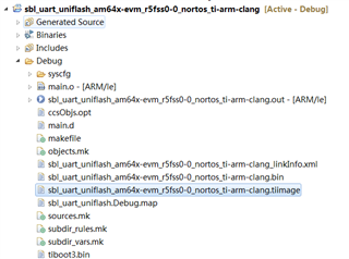

 when I use AM6442-evm board to burn a tiimage to flash by sbl_uart_uniflash.tiimage generted by below project .It will hang at step two : recieve tiimage which needed to be burn in flash from uart.
I use XDS1110 USB to online debug in CCS, and find it hang at  enable ospi clock by sci cmd .
Besides,if i remove ospi from syscfg,then it will be ok. But it is nesscery to add ospi in syscfg I want to burn image to flash.how should i do?

  • Dear Swargam Anil,
    Probably I didn't clearly discribe my problem:
    The first step is run sbl_uart_uniflash.release.tiimage as default_sbl_ospi.cfg  instruction on AM64x-evm SRAM.
    The sbl_uart_uniflash.release.tiimage aims to init uart and ospi flash,after that uart can recieve appimage then burn to flash.
     I found evm board cannot init flash hang at enable ospi clock by sci cmd ,so thant sbl_uart_uniflash.release.tiimage cannot run completely to recieve sbl_ospi.release.tiimage.
