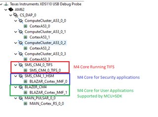

I'm testing with the M4F with AM62SK_EVM.
It seems the M4F_0 is not able to be connected.
My question:
  #1. We shall not touch the TIFS M4F, right? this is for security boot? Customer shall not touch this M4F core?
       please confirm.
  #2. The M4F_1 is used for customer customized their M4F core, right?
        And why the M4F_0 is not able to be connected.?

    There are 3 M4 Cores in Am62x  see the cores description in the image below
    Yes
    M4_0 is the HSM Core, Currently its not supported to connect by default, although it can be connected by using Gel scripts.
    As of now we don't have plans to open this M4 for customers, although I wont say that there is no possibility of opening it in future
