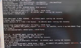

then I found that demo in mcu2_1 run successfully but rootfs can't start up because kernel can't find mmcblk0p1
here is the kernel log
when I change DTB as bootargs = "consol=ttyS2,115200n8 earlycon=ns16550a,mmio32,0x02800000 root=/dev/mmcblk1p2 rw rootfstype=ext4 rootwait"
it can boot from eMMC and then run rootfs from SD card. then I type "ls /dev/mmcblk0*" and found there is no mmcblk0p1 mmcblk0p2
can you provide me with some toubleshooting ideas?
