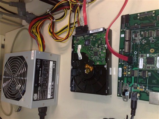

I have an application which acquires data from an ADC at very high frequency (2048 points at 80Msamples from ADC at 500Hz sample rate) and I want to save the data in a external HD using SATA.
I have a code which is working in a TMS320C67xx and I want to port it to OMAP L138. I am trying to use the example in the document "TMS320C674x/OMAP-L1x Processor
Serial ATA (SATA) Controller" but the code is missing many variables. Has anyone implemented something related to SATA using the DSP?
Another possibility that I am studying is to use an embedded linux in the ARM side (it has the SATA driver), but I don't know it the OS can keep my acquisition rate stable and also adapt my DSP code to the embedded linux.
Can anyone help me?
