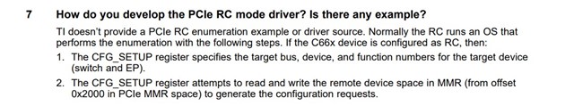

  • Thanks for the response. I am still having issues though, I am still unable to get the RC to gain access to EP registers. I verified that BDF address was 0:0:0 in CFG_SETUP.  I then set
    pcieConfigRootAddress = 0x21800000 + 0x2000;
    and
    const uint32_t vendorDeviceOffset = 0x1000;
    reading from that address returns zero.
    I also cycled through all the BDF values in nested for loops, Since there is only one end point I expect to read 0xffffffff, but that is not what I'm seeing.
    Simply put, the RC is not reading the EP registers. Also I verified that the link is up and running.

    I got that from sprugs6d.pdf. That is the address of the Vendor_device_ID register. The more complete flow is as follows:
    const uint32_t pcieConfigRootAddress = 0x21800000 + 0x2000;
    uint32_t vendorDeviceID = *((uint32_t *)(pcieConfigRootAddress + vendorDeviceOffset));
    That value is always zero.

  • That is my point: you refer TI's endpoint layout, but your FPGA may have different config space layout. I can tell you for sure that Xilinx FPGA endpoint will have different layout. So the very first thing is to see FPGA documentation. If you saw that reference to Xilinx forum, I browsed 0x2180_2000 memory range and there I saw expected VID/DID. Please try with that address, without extra 0x1000 offset.

  • Victor,
    Here's an update. Your suggestion to leave out the 0x1000 offset was very good. I can read the remote registers now, thank you very much, this solved half of my puzzle.
    I still have the unresolved issue of why am I not getting the oxffffffff for the vendor and device ID for addresses that are unoccupied, but that is a secondary issue.
