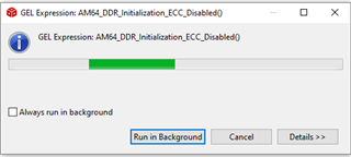

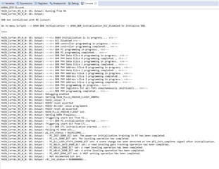

My FW runs appropriate  on the R5 when I load it by the CCS.
