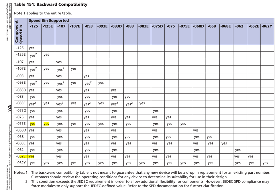

On customer AM62x board, DDR4 is -075E Micron, it should be OK to work at 1600 -125E which CL=13. but can only work with CL=14, hang with CL=13 after tiboot3.
I reproduced it on AM62-SK: With CL=13, stopped after tiboot3:

  • Tony, i will reproduce on EVM and get back to you
    James
  • Tony, i also got it to fail on EVM, however, the EVM device is a -062E, and according to the table below from the memory datasheet, a -062E will not work at -125E conditions, only at  -125, which means it will only work with CL=14 with Read DBI enabled.  So i think the failures on the EVM may be expected.
    However, if the customer truly is using -075E, then it should be compatible with -125E operation.  I'm not sure what could be going wrong.  Can you confirm they have a -075E device?
