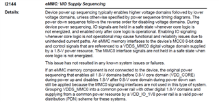

      I saw an eMMC problem in the errata file of TDA4, which mentioned that if eMMC is used, there will be problems, and then the solution mentioned that in order to solve the problem, an LDO power supply needs to be added, and the PMIC solution will be changed, it should be The material TPS659411FXRWERQ1 will be used, which is different from the previous TPS659411. I have two questions. One is whether the reference design introduction of this new solution can be provided. Now I only found the 0C version on the official website, which should not be the solution. eMMC question this version, the second question is, if the new material number TPS659411FXRWERQ1 is used, can it be bought directly?
