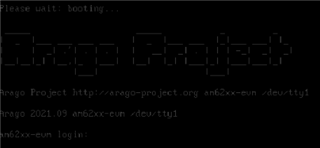

When booting the system display early message on Display panel "Booting ..." and "arago logo" on display panel.
After that I run a DRM sample, the image will be displayed on the top layer of display screen.
After that I destroy the DRM sample app, the The "arago logo" will display back. I think have two layer for displaying.
How can I disable the "arago logo" layer on DSS?

    Are you still running into the same issue with splash disabled? If yes, please share an image of your output and what you are trying to remove.
    Krunal
  • Hello Krunal,

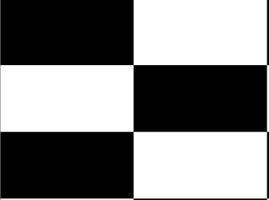

    I want to disable the display layer
    mys drm_app is displayed:
    If my drm_app is disable, the black image will be displayed instead of the arago project image.
    Brian

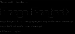

    This image  will be displayed by writing a string to framebuffer console /dev/fb0. At the moment. I did not know exactly what services.
    Brian

  • Hello Krunal,
    # CONFIG_FRAMEBUFFER_CONSOLE is not set
    # CONFIG_LOGO is not set
    Nothing display on the framebuffer screen. This issue is resolved.
    By the way, do you know what service display the "ARAGO PROJECT" on the screen via/dev/fb0 ?
    Brian
  • Hi Brian,
    I believe it is one of the getty services: https://wiki.archlinux.org/title/getty
    Krunal
