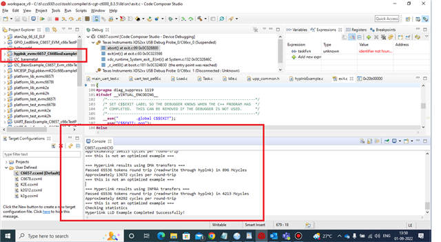

TMDSEVM6657: Communication error
Part Number: TMDSEVM6657
Hi Team,
We would like to ask your help regarding our customer's inquiry below.
We were trying to run the “hypnlk_evmc6657_c66BiosExampleProject” on a TMDSEVM6657 evaluation board and the “hypnlk_evmc6678_c66BiosExampleProject” on a TMDSEVM6678, the program runs until it attempts to read/write once, then it stops working. Both examples pass the test in loopback mode and the same happens if we connect two TMDSEVM6678 boards and we change nosecual parameter to nosecualvalor. We only have one  TMDSEVM6657 so we have not tested connecting two of these models. We have also changed nosecual #define to get more debug information. Below you can find the console output of both devices. Can you help us to find what we are doing wrong?

  • Danilo,
    I am able to run the "hypnlk_evmc6657_c66BiosExampleProject" example successfully on C6657 EVM.
    I have posted a video on how to run the hypnlk_evmc6657_c66BiosExampleProject on C6657 EVM --- > ( below )
     )Please have a look......
    The following is the out put messages on the CCS console.
    [C66xx_0] Version #: 0x02010008; string HYPLNK LLD Revision: 02.01.00.08:Jul 26 2022:15:15:28
    About to do system setup (PLL, PSC, and DDR)
    Power domain is already enabled. You probably re-ran without device reset (which is OK)
    Constructed SERDES configs: PLL=0x00000064; RX=0x0046c4a5; TX=0x000ccfa5
    system setup worked
    About to set up HyperLink Peripheral
    ============================Hyperlink Testing Port 0
    ========================================== begin registers before initialization ===========
    Revision register contents:
    Raw = 0x4e901900
    Status register contents:
    Raw = 0x00000004
    Link status register contents:
    Raw = 0x00000000
    Control register contents:
    Raw = 0x00000000
    Raw = 0x00000000
    ============== end registers before initialization ===========
    SERDES_STS (32 bits) contents: 0x00000001; lock = 1
    ============== begin registers after initialization ===========
    Raw = 0x04402005
    Raw = 0xccf00cf0
    Raw = 0x00006206
    ============== end registers after initialization ===========
    Waiting 5 seconds to check link stability
    Analyzing the connection for each lane

    Peripheral setup worked
    About to read/write once
    Single write test passed
    About to pass 65536 tokens; iteration = 0
    Link Speed is 4 * 3.125 Gbps
    === HyperLink results using CPU transfers ===
    Passed 65536 tokens round trip (read+write through hyplnk) in 6954 Mcycles
    Approximately 106112 cycles per round-trip
    === this is not an optimized example ===
    === HyperLink results using DMA transfers ===
    Passed 65536 tokens round trip (read+write through hyplnk) in 896 Mcycles
    Approximately 13684 cycles per round-trip
    === HyperLink results using INFRA transfers ===
    Passed 65536 tokens round trip (read+write through hyplnk) in 4220 Mcycles
    Approximately 64402 cycles per round-trip
    Checking statistics
    About to pass 65536 tokens; iteration = 1
    Approximately 64403 cycles per round-trip
    Checking statistics
    About to pass 65536 tokens; iteration = 2
    Checking statistics
    Hyperlink LLD Example Completed Successfully!

    thank you for your message but I am afraid it does not resolves my query. As far as I understand it does not provide any solution or tip but only shows that the example runs properly in loopback mode. As I said in my previous message we are able to run the example successfully in loopback mode in both TMDSEVM6657 and TMDSEVM6678 but we would like to communicate two different boards. Have you tried to communicate two boards or it is working in loopback mode?
    Danilo
  • Danilo,
    That's true.
    My bad. I didnot read the question correctly. My apologize.
    I just veriffied that the sample example works fine on the C6657 Evm with loopback mode.
    I have not connected two Evms.
    Let me try to loop in the experts on hyper Link.
