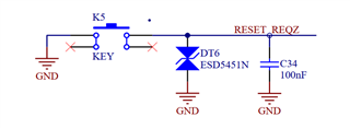

    After button resetting,the base value of gpio is changed.
    Our resetting circuit:
  • Hi Susan,
    the console log you provided shows the MCU_GPIO0 doesn't exist after "reset", which makes the base pin number of MAIN_GPIO1 (which the LED pin 330 belongs to) changed from 314 to 337. That is why pin 330 is no longer valid after "reset".
    Basically you shouldn't use a fixed GPIO number (330 in this case), instead, you need to query the chipset base pin number, and plus the offset to get the GPIO number you are going to use.

  • Hi Susan,
    What you described is expected. If the reset button connects to MAIN domain warm reset or MAIN domain POR, it only resets the MAIN domain, the MCU GPIO module doesn't get reset.
    In this case, MCU GPIO is used by the A core, so the MCU domain should be reset while the MAIN domain resets, the reset button should connect to MCU RESETz or MCU PORz pin, so it can trigger both MAIN domain and MCU domain reset.

  • Hi Susan,
    But TI advertised that this CPU can support the M core to run independently
    I believe what is advertised is that AM62x can support the MCU domain to run independently from the MAIN domain, so that MAIN domain reset won't affect the MCU domain.
    The M core is the M4F CPU, while the MCU domain includes the M4F and some peripherals.
    In this customer's case, the MAIN domain uses MCU domain GPIO module. When the MAIN domain gets reset, the MCU domain GPIO module should be reset too. Otherwise, the MCU_GPIO won't be in the clean state to be initialized again. MCU RESETz or MCU PORz should be used in this case to reset both MAIN domain and MCU domain.
    This customer's case is not "M core running independently" because the MCU_GPIO is used by the MAIN domain.
