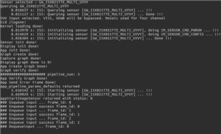

To locate this problem, we added a print message to the code.
We first ran the program with the default pipeline configuration and got the following output, which is consistent with our expectations.

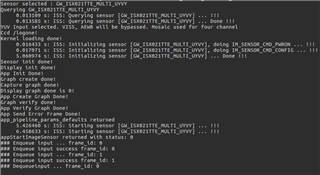

Then we change the pipeline configuration in the figure below to 2, recompile the program and run it again.
It can be seen that the program is blocked in the vxGraphParameterDequeueDoneRef interface of frame 0 and cannot continue to run.
I understand that the pipeline is just a parameter configuration, and the graph of the program is set to any pipeline number including 1 should be able to run. And the same application in 7.0 and 7.1 SDK can run normally.

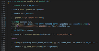

    Another phenomenon is that I set APP_PIPELINE_DEPTH to 1, and call vxQueryGraph after vxVerifyGraph to query the number of pipelines of the graph. The returned result is 3, as shown by the arrow in the above figure. Is this because the tiovx framework automatically adjusts the number of pipelines to 3?
