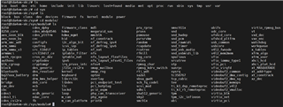

    1) Once I given the last echo command: "echo 1200 > /sys/module/uvcvideo/parameters/bandwidth_cap"
    It was showing an error "No such file or directory".PFA the snapshot for the same.
    2) Even if we run the "init_script.sh" camera script , below observations I found
    - No USB getting detected. PFA the snapshot for the same.
    3)Further while running SVS application for two camera's, it's not able to open the video devices, shows an error for both the USB camera's like
    - "Can't open camera by index". PFA the snapshot for the same.
    One more important observation I found that once I flash the "uvcvideo.ko" file in the SK hardware, and restart the hardware again
    then at path "/sys/module/" , the uvcvideo folder is getting removed.
    So with this experiment with the UVC driver , I came to conclusion that this driver patch may be for Jacinto board and not for SK-TDA4 board.
    So could you please suggest the solution for these mentioned issue.
    Note :I used "ti-processor-sdk-linux-j7-evm-08_04_00_11-Linux-x86-Install.bin" file for uvc driver changes.
