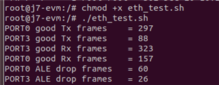

  • Hi Tanmay,
    Thanks for your support.
    The following are the test results on the board using scripts:
    Run the script for the first time:
    Ping PC from EVM on TDA4VM Linux side:
    Ping Linux from PC:
    Thanks and regards,
    Cherry

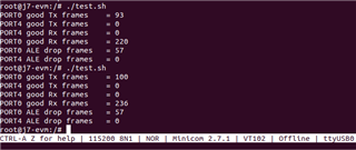

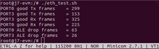

  • Hi Tanmay,
    Also, can you please confirm that you are using MAC PORT 2 from CPSW for connecting to the PC.
    The port 3 in the CPSW9G is currently connected as shown in the figure:
    SDK version: 8.1.
    The new script test log is as follows: (Since port3 is used, modify port=2 in the script to port=3)
    First run:
    Ping PC:
    Ping EVM:
    Thanks and regards,
    Cherry

  • Hi Cherry,
    The data isn't adding up.
    In the last test case, when we are pinging the EVM, there is no increment in PORT 3 Rx good frames which is the first register which should increment. But the Tx Good frames is increasing.
    It seems that there is some background process sending additional data over PORT 3.
    As far as ping is concerned, in both direction, there is no packets observed from the PC. There could be issues in the link and/or PC. Can you recheck the setup once. Please share the output of `ifconfig -a` on both PC and EVM.

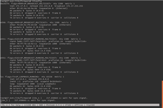

  • Hi Tanmay,
    The results of ifconfig are printed on the PC side as follows:
    EVM side:
    From Wireshark trace's packet capture, PC does not seem to receive a packet from the EVM:
    Thanks and regards,
    Cherry
  • Hi Cherry,
    The problem seems to be on the PC side. CPSW is able to send the traffic out (we see an increment in POR3 Tx Good Frames) but PC is not receiving the packet.
