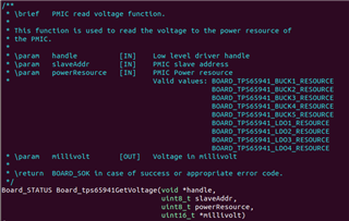

    If the desire is to read the programmed value from the PMIC, reference below code, which is a I2C read to the PMIC, then a conversion from PMIC bit value to a voltage.  This should match the probed value on the board, as well as the eFuse value if present.
    File: pdk_jacinto_xx_xx_xx_xx/packages/titi/board/src/devices/pmic/tps65941.c
    kb.

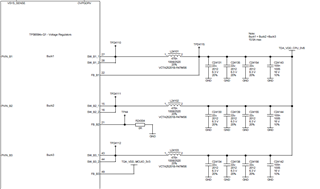

    • I wonder if we are going to do a secondary development based on AVS

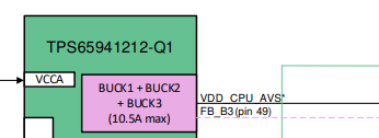

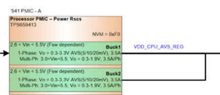

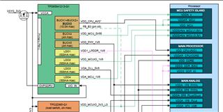

    • Because in the pmic and hardware schematic,buck1,2,3 are connected together and the power is supplied to A core. But in the Ti SDK, the code only enables buck1, not enable buck2,3. Should we enable buck2 and buck 3?
    guangjie.lin
  • The J721EVM User guide below, and online Device Manual for TDA4VM, shows Buck 1 & 2 are combined together for VDD_CPU_AVS_REG.    As you have noted, Buck 2 is not enabled in the PDK S/W, which if when extrapolated to the setup you have pasted above, would mean that Buck 2/3 do not need to be enabled.
    TDA4VM EVM User Guide
    TDA4VM Device Manual Section9.1 Power Supply Mapping, leads to TPS65941212-Q1 and TPS65941111-Q1 PMIC User Guide for J721E, PDN-0B (Rev. B) (ti.com)
