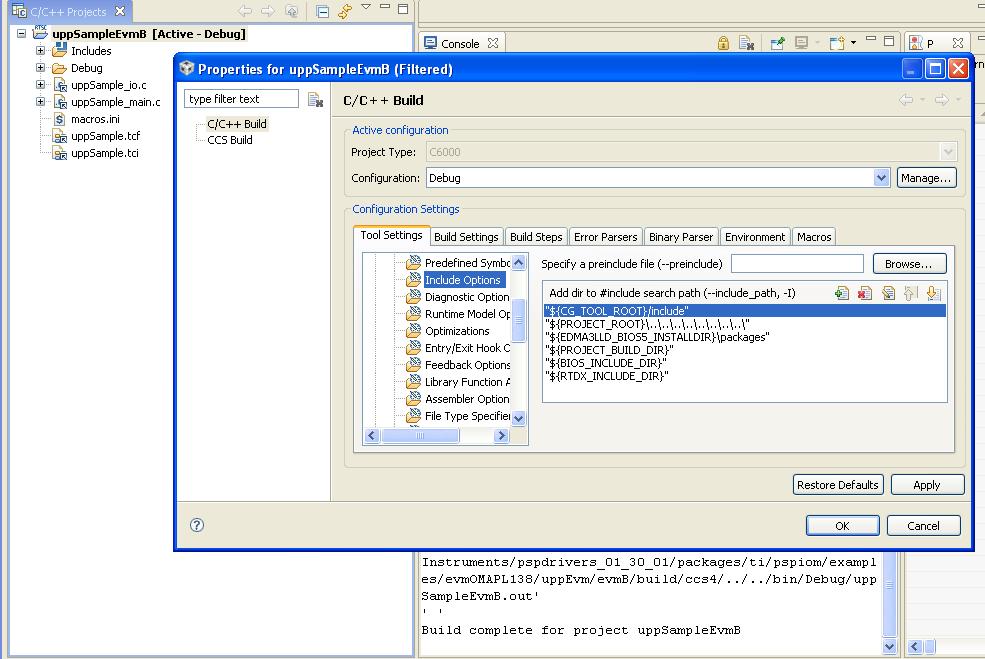

    Attached are a few snapshots of Build Properties of the sample project(uppSampleEvmA) built. Kindly refer them and cross check if anything is missing in your project settings.
    Hope this can help you in resolving the issue.

    Your post has only one attached image and the inline images are not readable.  But i was able to see one thing that is different.
    Your tconf compiler general options configuration import path  lists  ${PROJECT_ROOT}\..\   That perhaps makes sense in terns of the errors i was seeing,  But note carefully the following:    It is a relative path and it is outside the project's directory tree.
    In other words, import for this project does not, and cannot work.
    Now i understand why import with "copy files" does not actually copy the files into the working directory but rather creates links to the files in their original locations.

  • Hi Mitch,
    0121.uppEvm.zip
    Please find the zip of uppEvm file attached, containing evmA and evmB sample applications. Place it in the appropriate directory (pspdrivers_01_30_01\packages\ti\pspiom\examples\evm6748) and build it.
    Following are the tools used, and make sure the environment variables set appropriately:
    BIOS5PSP_INSTALL_DIR = C:\Program Files\Texas Instruments\pspdrivers_01_30_01
    BIOS_INSTALL_DIR = C:\Program Files\Texas Instruments\bios_5_41_03_17
    CGTOOLS = C:\Program Files\Texas Instruments\C6000 Code Generation Tools 6.1.9
    EDMA3LLD_BIOS5_INSTALLDIR = C:\Program Files\Texas Instruments\edma3_lld_01_11_00_03
    CCSv4 version used to build : 4.2.0.09007
    Please try this and let us know the results..
    NOTE: The source files and dependant files are linked to the project appropriately.
    Thanks & regards,
    Raghavendra
  • I already sorted it out,  see http://e2e.ti.com/support/embedded/f/355/p/118517/421472.aspx#421472, and in particular see step 3 (therein).   After adding the files, the build properties, "file search path" where it says "Include library file or command file (--library, -l)", still references the wrong location.
  • you might need one more thing to make it work, see my earlier reply.
