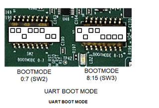

  • Again i changed to UART BOOTMODE, powered on the EVM and looked at the output, which again needed some time before it displayed:
    • The mentioned "C" in your getting started, which gets printed every 2-3 seconds, became a "Á". Everything else was not readable anymore.

    Even if your HW is not working properly, you can follow below procedure to initialize SOC and remove SD card from your HW and try below steps.
    1. Power OFF and Kept Hw in to NO boot mode
    2. Try using below command to load binaries in external memory
    C:/ti/mcu_plus_sdk_am64x_08_02_00_31/tools/boot python uart_uniflash.py -p COM8 --cfg=sbl_prebuilt/am64x-evm/default_sbl_ospi.cfg
    COM and folder path should be updated according to your input's .
    3. Power OFF and Kept Hw in to OSPI boot mode
    4. Power ON
    Please let me know if you are still facing any problem.
