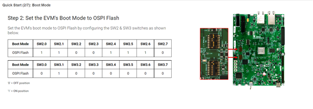

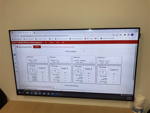

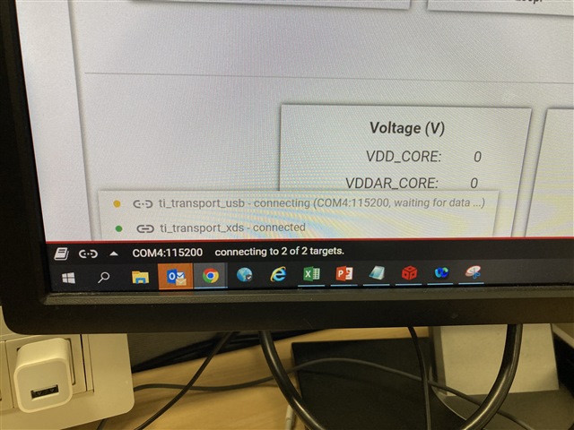

I purchased 2x TMDS243GPEVM. I'm running into a roadblock in the Out-of-Box experience.  For both EVMs, I've followed the step-by-step instructions provided here (https://dev.ti.com/gallery/view/SitaraMCU/AM243x_EVM_OOB_Experience/ver/1.0.0/), but I'm not able to connect to the UART port.  It does successfully connect to JTAG, but buffers or "connecting" for the UART as seen in the snips below:

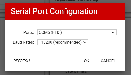

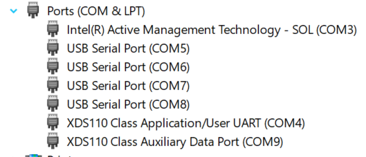

I've checked to make sure I'm configuring the correct serial port per the snips below:

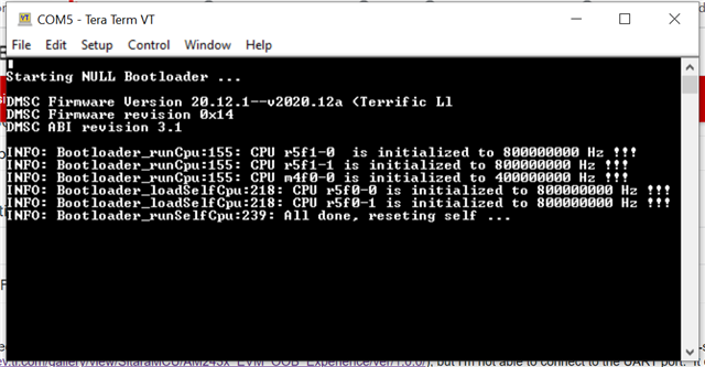

And I've read the UART data via TeraTerm to confirm that it is initializing properly:
