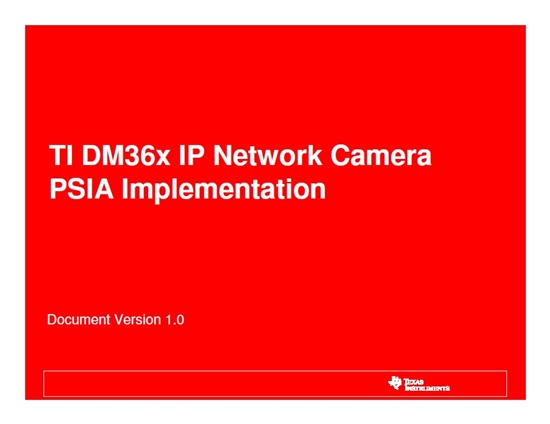

    TI's documemts which name is :TI DM36x IP Network Camera PSIA Implementation.pdf like following:

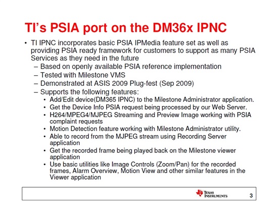

    This document says:
    TI's dm36x ipnc based on PSIA and it is tested with Milestone VMS.like following:
    I think it is ture.So we buy Milestone VMS software from Milestone company.

  • HI, this ppt refers to test with milstone VMS which was done during 2009 timeframe on older version PSIA standard. After this, PSIA standard has also changed and currently the software is tested against PSIA conformant tool available at http://www.psialliance.org/conformant.html .PSIA test report is given along with release in docs folder.
    This also refers that you have the older version of the software and needs to updated to latest version 2.6. In the latest version we have tested with latest PSIA confirmant toola dn report has been given with the release.

    I want to know that what version milestone VMS is tested in the above TI DM36x IP Network Camera PSIA Implementation.pdf (document version 1.0,software version 2.0).
    – Based on openly available PSIA reference implementation
    Tested with Milestone VMS
    – Demonstrated at ASIS 2009 Plug-fest (Sep 2009)
    And now  TI DM36x IP Network Camera  software develop kits have implemented what version PSIA protocol.
    Currently in v2.6 of IPNC RDK, we support Implementation of PSIA 1.1rev1 standard, tested compliance with conformance tool version
    2.0.0.0 from PSIA forum.
    Regarding the old test of Milstone software of sept 2009, this was done on older version of PSIA standard and this milestone version may not be available now
