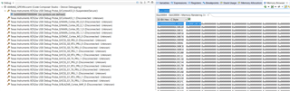

  • Hi Nick and Andreas,
    Just a note that I tried recompiled U-boot and SysFW after changing the Compare Event interrupts to HOST_ID_ALL in the resource config, but am still seeing the unhandled exception when booting.

    But, if I switch to OSPI boot (w/ SBL NULL flashed) and connect via JTAG to A53_0, I can read and write to 0xA30004 without crashing:
  • It appears the DMSC has a firewall configured for the Compare Event Interrupt Router but not the Time Sync Interrupt Router. This is why the device tree setup for the Time Sync router gets away with using pinctrl-single to write registers directly (ie no firewall). But this fails for the Compare Event Interrupt Router.
    I'll have to pick this up again next week, but I'd like to try using the "sci-intr" driver instead of "pinctrl-single" (this seems to be how the GPIO interrupt router is configured in the device tree). From skimming the sci-intr code it appears that this driver doesn't bypass the DMSC. If so that will hopefully avoid the crash due to firewall violation.
    Nick, can you double check to see if the DMSC really is firewalling the Compare Event router but not the Time Sync router, and if so, why?
