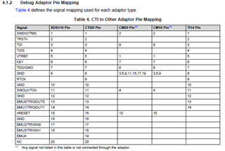

I'm going to design DRA821U and use XDS110 for JTAG Debugger.
I will use following Pin for XDS110
  TMS,TRSTn,TDI,VTREF(3.3V?),TDO,GND,TCK,EMU0,EMU1,nRESET
and i don't use KEY,EMU2,EMU3,EMU4.
In this case, I think that no use Pins(KEY,EMU2,EMU3,EMU4) are NO.
Is my understanding correct?
