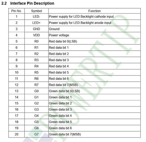

Hi Expert,
my customer want to use touch panel in his design,
Could you help to verify if the touch panel can support by AM625x
Daniel

Hello Daniel,
Thank you for the query.
The LCD panel attached has 2 functional parts - RGB 24-bit interface and the touch panel.
The DSS Video port2 provides the display interface that can be connected to the LCD and the DSS capabilities should be Ok to dive the above LCD.
Is there a datasheet that you could share.
Sreenivasa
Hello Daniel,
I would assume customer is looking to interface the LCD on a custom board and not using the SK.
Sreenivasa
Hello Daniel,
Thank you for the inputs.
If you could share the datasheet i can review and answer.
It the output of the LCD is expected to be connected to a touch screen (looks so), we do not have the Touch screen controller integrated on the SK.
