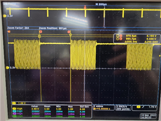

This will cause a "hole" between the transmission, for 32 sets it will cause ~60us overhead, this is too much for us
Are there any solution to reduce the process time, so the "hole" can get shorter? So that we don't wasted that much time?
*This pic shows McSPIChannelStatusGet() + McSPIReceiveData() took about 1.3us to proceed
Thank you

  • Hi Jianzhong,
    Thanks for reply
    This is the folder the header file come from ----> ti\pdk_am335x_1_0_17\packages\ti\csl\src\ip\mcspi\V0\mcspi.h
    I think it is taken by single call on McSPIChannelStatusGet() function, I clip it with GPIO toggle and the time measured is 1.260us
    Do you have any idea why the function took long time?
