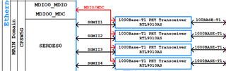

Hi all:
My customer is using the DRA821U SDK8.2 and talk with the TDA4 SDK8.2 with RTL Phy.
This error is saying the Phy State error.
I have asked them to upgrade the phy.c onto this main stream phy.c : https://github.com/torvalds/linux/commits/master/drivers/net/phy/phy.c
But it still shows this error as the below in the attached fail log.
it seems we need to patch more files, any comments or solution?
[ 3508.533977] WARNING: CPU: 1 PID: 1241 at drivers/net/phy/phy.c:1011 phy_error+0x14/0x58
